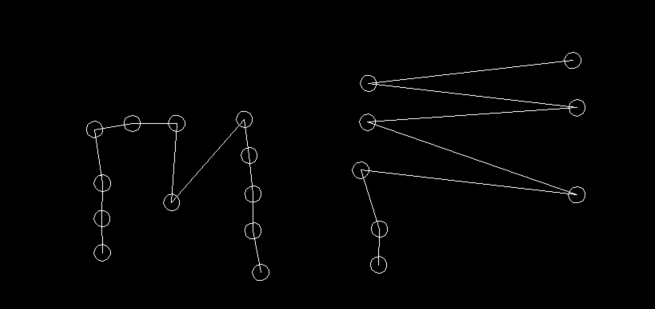

duke Posted May 4 Share Posted May 4 Hello friends !! I was wondering about XDATA, What is it for and how does it work within AUTO-LISP Because I don't know exactly if it works for what I'm thinking. Maybe you can create objects, for example: CIRCLES and internally assign each circle an internal data to each one, so that each and every one of the circles has a unique and unrepeatable and totally identifiable "NAME" Example: To join all the circles with a polyline, in a specific order, say from the circle called internally with a number 1 (ONE), to the circle number 5 (FIVE). Or XDATA is not used like that I put that as an example, but if it is used for other things, could you write me a small example code to understand how XDATA works, please Something very simple and small, you can And in advance, thank you very much ‼‼ Quote Link to comment Share on other sites More sharing options...

BIGAL Posted May 5 Share Posted May 5 (edited) "Joining circles via creation order", using ssget can most times do this, try it, but as was posted somewhere else doing a sort on the "Handle ID" of the objects is creation order. I seem to remember must change to a number not hex. Quick and dirty (defun wow ( / ss x) (setq ss (ssget '((0 . "CIRCLE")))) (command "pline") (repeat (setq x (sslength ss)) (command (cdr (assoc 10 (entget (ssname ss (setq x (1- x))))))) ) (command "") ) (wow) Edited May 5 by BIGAL 1 Quote Link to comment Share on other sites More sharing options...
duke Posted May 5 Author Share Posted May 5 (edited) 1 hour ago, BIGAL said: "Joining circles via creation order", using ssget can most times do this, try it, but as was posted somewhere else doing a sort on the "Handle ID" of the objects is creation order. I seem to remember must change to a number not hex. Quick and dirty (defun wow ( / ss x) (setq ss (ssget '((0 . "CIRCLE")))) (command "pline") (repeat (setq x (sslength ss)) (command (cdr (assoc 10 (entget (ssname ss (setq x (1- x))))))) ) (command "") ) (wow) ty BIGAL beauty example for creating a pline ‼‼‼‼‼ Edited May 5 by duke Quote Link to comment Share on other sites More sharing options...
